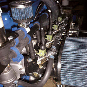

cheers for the replys, iv been scratching my head thinking about how to install the injectors, and have a few ideas
1. Fabricate a fuel real from aluminium bar and get it welded etc as many people have done
2.Make a fuel rail using high quality fuel hose and metal t pieces, i seen this done on a few engines buy professionals, easy to do but what do you think?
3. try and adapt the original CA18ET fuel rail
Personally i like option 2. as its the easiest and cheapest ill see if i can post a picture to show you what i mean.
Any body got any thoughts on this?

Heres the picture of the "flexable" fuel rail

anyone got an opinion on this?
30psi 08-08-2006 13:34
It will work providing it don't leak
turbozx 08-08-2006 15:03
good quality pipes clamps and t pieces should do the job!
