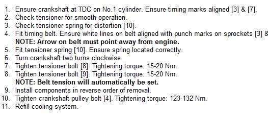

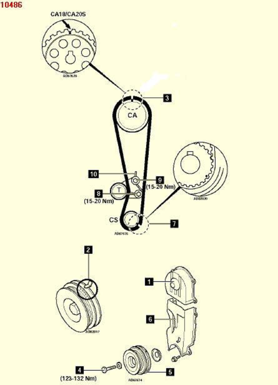

PukkaSilvia 07-05-2008 23:04
2 Attachment(s)
i have just uploaded the 2 links below which should help you. 1 is the diagram and the other is the instructions
http://www.nissansilvia.co.uk/vbb/at...7&d=1210197768
http://www.nissansilvia.co.uk/vbb/at...8&d=1210197849
