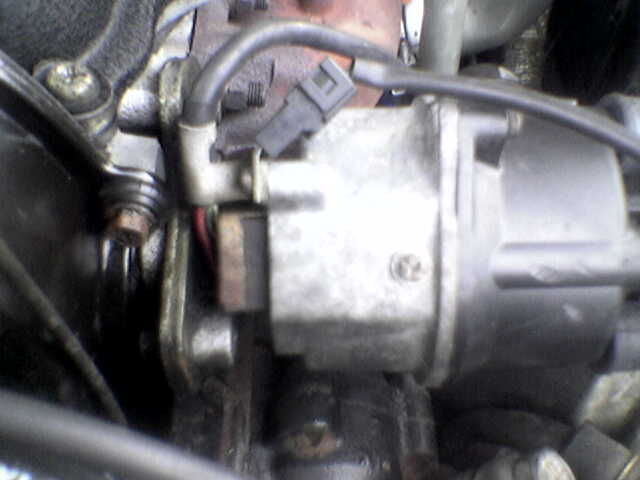

s12-newbie 15-12-2008 14:55
http://www.turbominis.co.uk/forums/a...s/260387-1.jpg

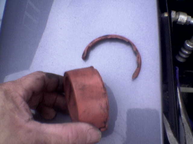

my boost hose than blew
http://www.turbominis.co.uk/forums/a...s/260387-2.jpg
