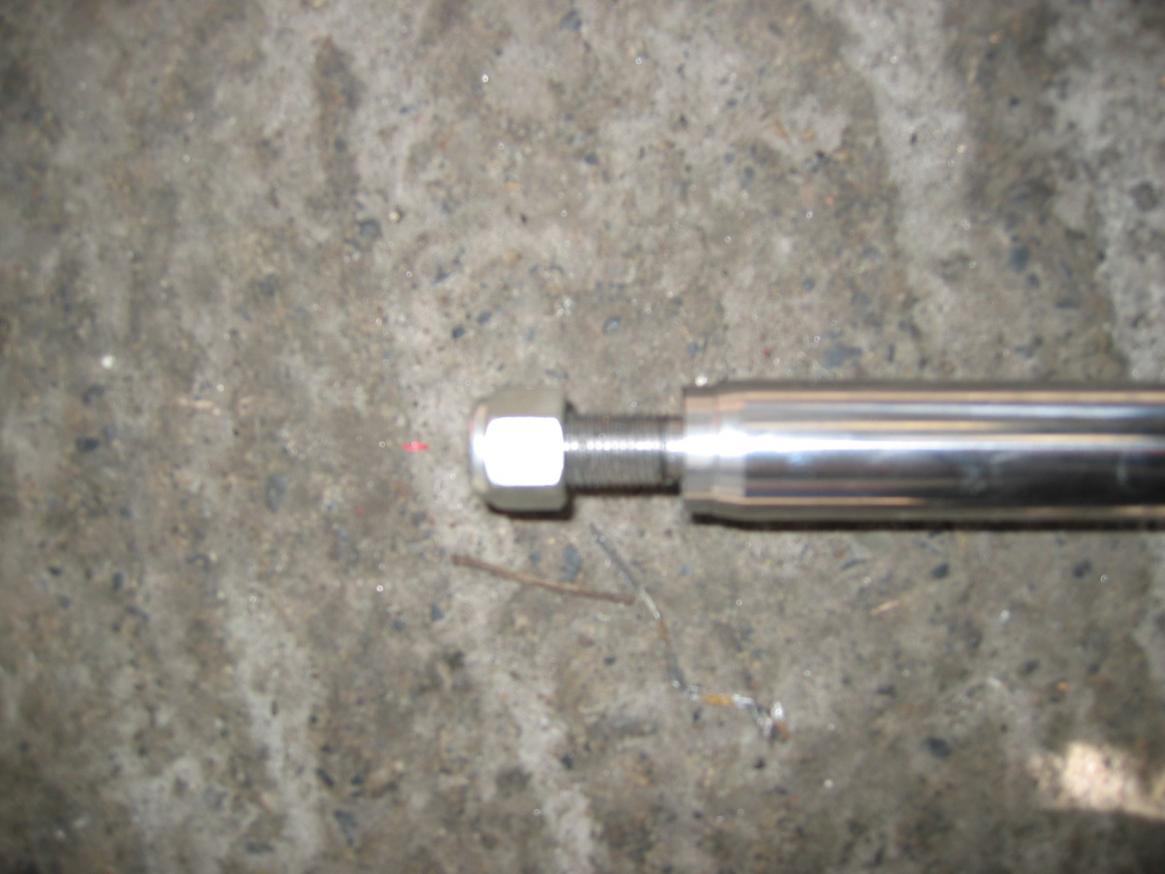

Basically it comes down to the fact that if your car is airbourne then the spring could fall out of its seat.Not that you drive around with your wheels off the ground.
The only way to fix it properly is by getting the shocks machined.
