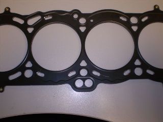

see pic of modified DET cometic to fit ET. this is actually the one Cweeks bought from TurboMike. it shows the extra two water way holes that need to be cut
my engine uses MIG wire block and std nissan HG too, i have lower comp forged pistons rather than thicker head gasket
