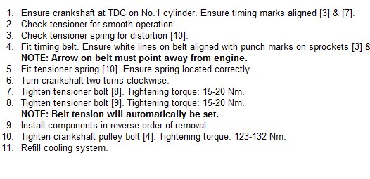

just puting a belt on my s12 and cant work out the timing marks on the cam pulley , can any one point me in the right direction ???
any help much aprecated
cheers nick

this will explain it
http://www.club-s12.org/forums/index...hl=timing+belt

i have just uploaded the 2 links below which should help you. 1 is the diagram and the other is the instructions
