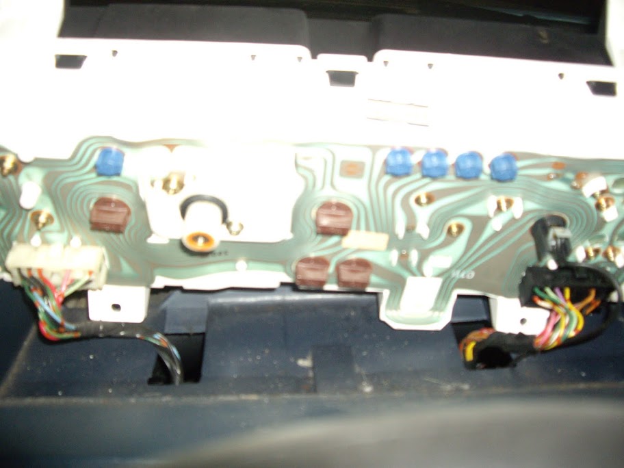

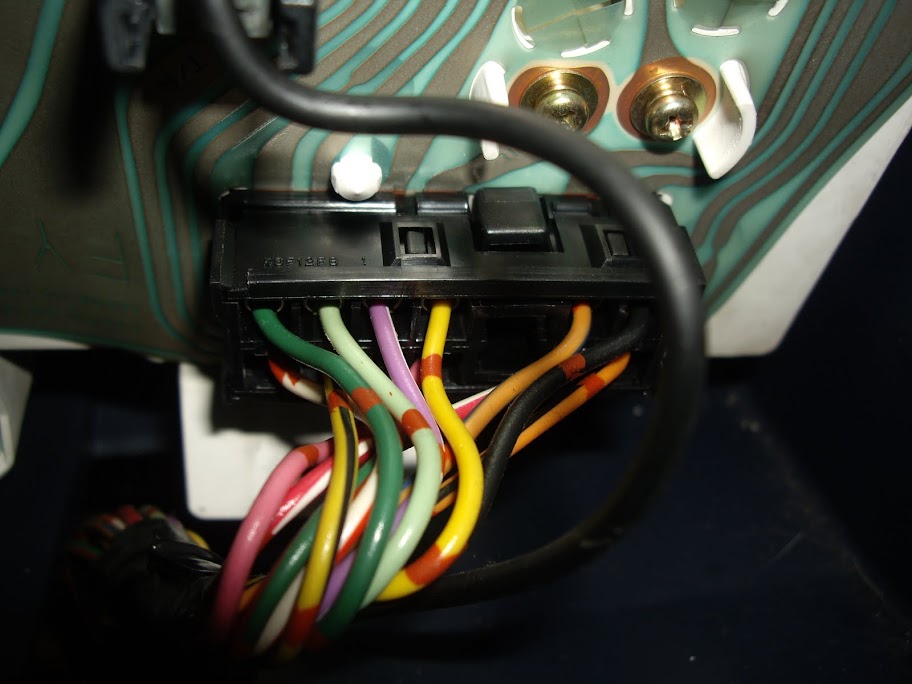

Here I have the Instrument panel out
Which wire would I splice into to get the Rev counter working?
Which wire is it I splice into at the Coil Pack side

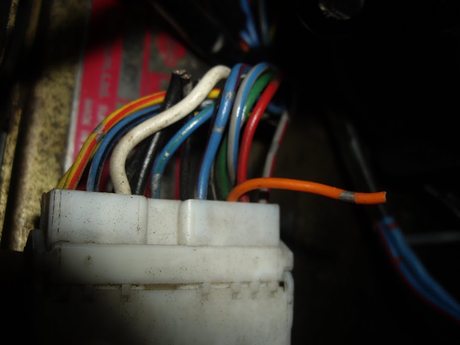

Is the blue black wire on the white block near the ECU the Temp Gauge wire? Should this be cut and extended to the ECU? Which PIN would it connect to in order to get the Temp Gauge working?

TACHO
the 4 wires from the ignitor that go to the coilpacks are the ones you splice 4 diodes onto then join the "cathode" (striped) ends together and join them to one wire which you run to your tacho. There is a light green wire at the back of the tacho, which you cut and join to this wire. You have to remove the instrument panel to get at the connector that has the light green wire in it.
in the pics above there is a light green wire on both plugs into the back of the instrument panel, is it the one on the right as you look at it?
The stripe on the Diodes is towards the tacho, as the current will only flow in that direction.
Someone on Club S12 has spliced in to the tach gauge signal wire, which is part of the S12 primary transistor wiring harness, down near the maf location. Where is this and which wire is it?
TEMP GAUGE
Find the blue/ black wire from the small white s13 plug. connect a wire to it, and run it up behind the instrument cluster. Next snip the purple/ white wire behind the cluster, which is the temp gauge signal wire, and connect the wire that you ran up to the cluster side of the purple/ white wire.

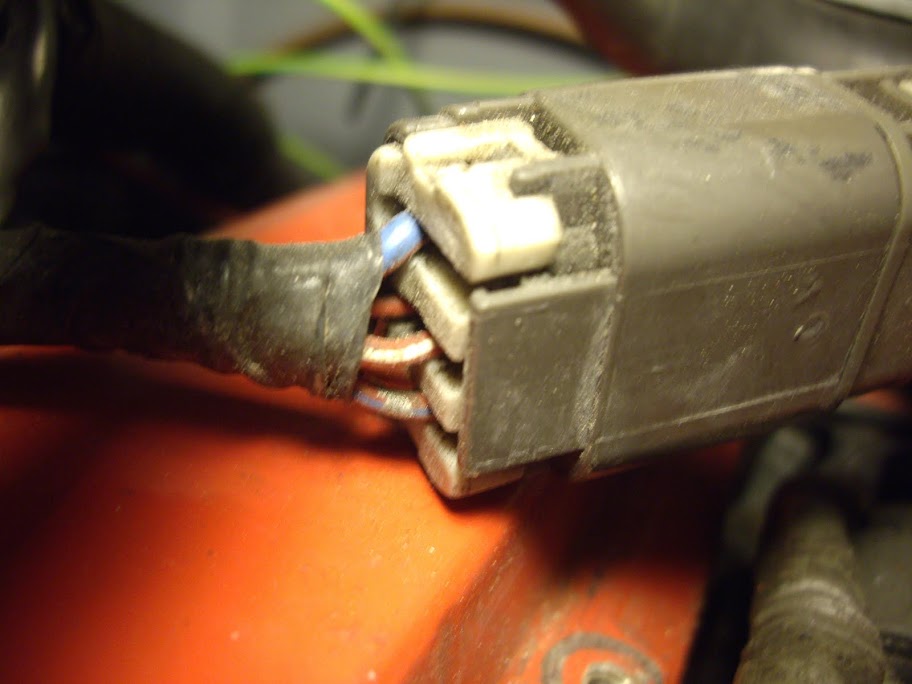

An here again from slightly further away showing the 4 seperate wires to be spliced into the coil packs

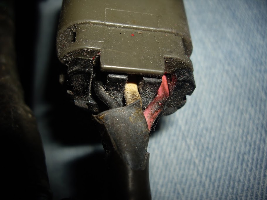

This is the plug that plugs into the Ignitor with 4 wires coming off it
Fig 1.

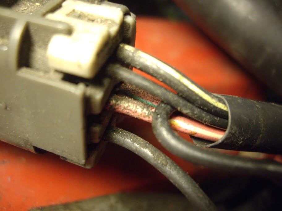

If you follow these wires through the loom they eventually end up at this plug. You can see them entering on the left hand side
Fig 2.
And again the same plug closer up
Fig 3.
These wires then come out of the other side of the plug in different colours (As Below) Which are the correct ones to splice into????
Fig 4.
I am completely lost trying to find the original blue signal wire from the original coil. Do I cut and join or Splice ??? Where is this???
If I dont use this original blue signal wire, is it the light green wire I should be using behind Tacho???

Sorted the Rev counter, worked like a dream.

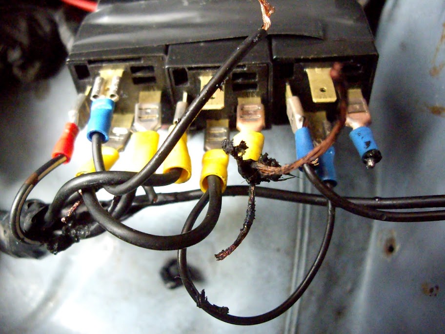

Started tidying the wiring up, moved the relays about 4 inches, one of the spades connectors came off and started to fizz the loom.
Now back to square one.
Not suffering the cost of sending it off again.
Any help would be gratefully appreciated will post a pic of the relays for any info on wiring new ones back in.

Oh no mate. Which relays is it, and I'll get you a picture tomorrow when i get to the car if someone doesnt beat me to it! At least you've worked out most of what goes where to the rest of the car loom now though

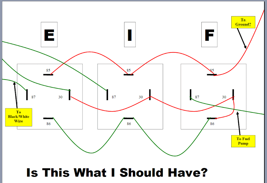

With regards the Relays This Is What I Have been left with.
And Again in a Diagram
Is This Below What I Should Have? If Pukka Could Clarify This that would be great
