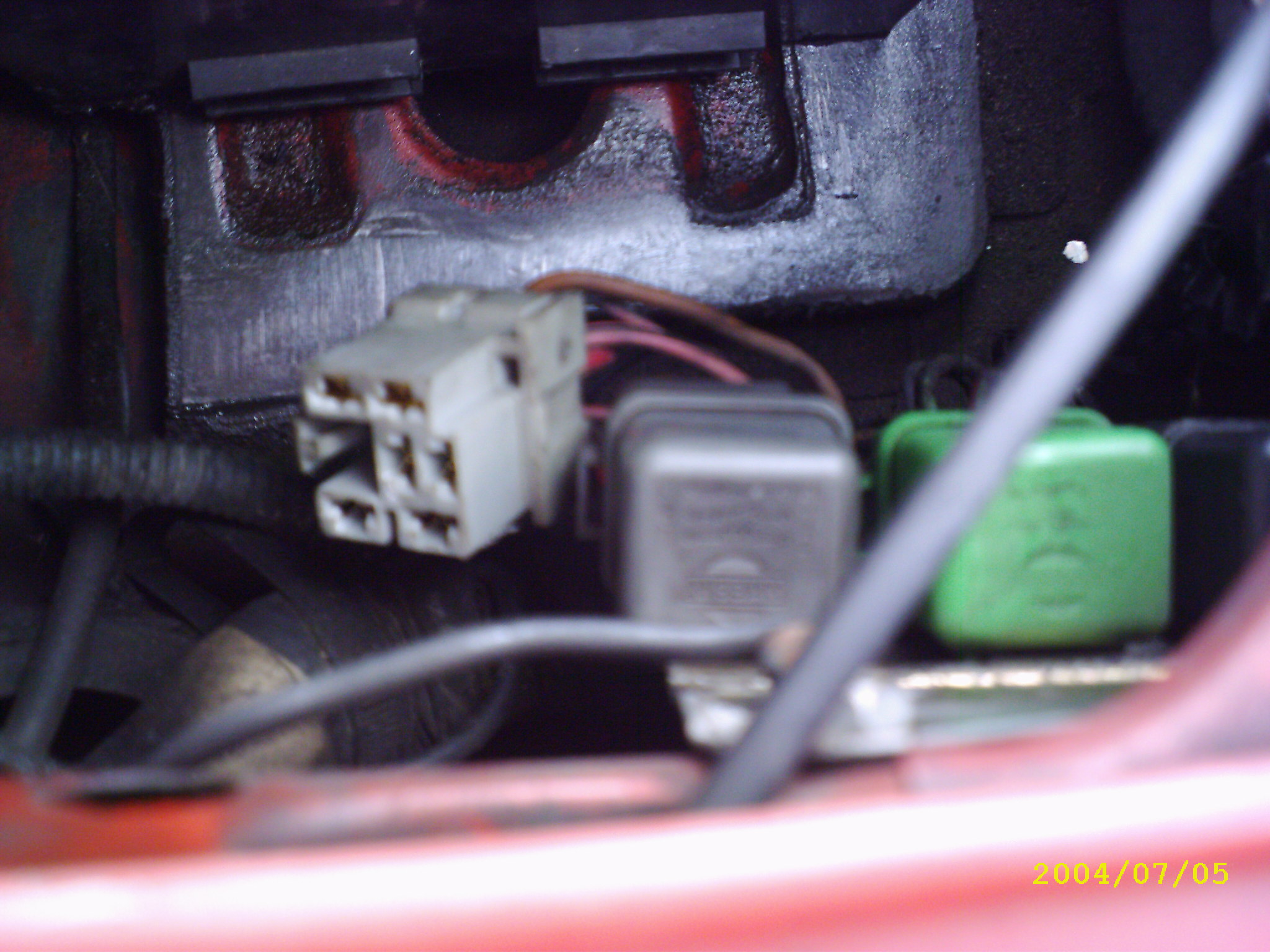

Here's a pretty useless pic I took back then. It's the relays next to the battery. IIRC, after I did the mod, the headlights still came on but didn't open on position one but opened on position two. I seem to remember being able to confuse it all with a combination of the popup switch and the stalk :P

Was just reading about doing it for the S13 and it all sounded a bit familiar - snipping the red wire with the blue line and silver dashes going into the gray relay may do it.
